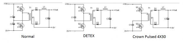

Dear MicrosiM, im looking some version of half bridge topology that implement the blocking Capacitor in differents ways, I attack the picture from 3 version that I check from differents designers, I want to know if changing the capacitor from voltage divider have some advantage from classic connection ??.
